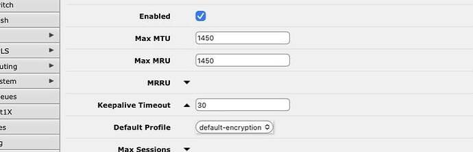

What is your MTU value? I had this issue with L2TP with ubiquiti. Solution was set MTU to 1492. When I switched to mikrotik I didn’t have the issue. Just checked and MTU is set to 1450

Mtu for ipsec? Or which interface?

my l2tp profile, basically just set the local and remote addresses, swapped to my local home dns, and added it to my interface lists

The L2TP server config

It’s 1450

I notice you have your default profile different than I do. Maybe there is something causing issues there

Like what? Can you show me your configuration
